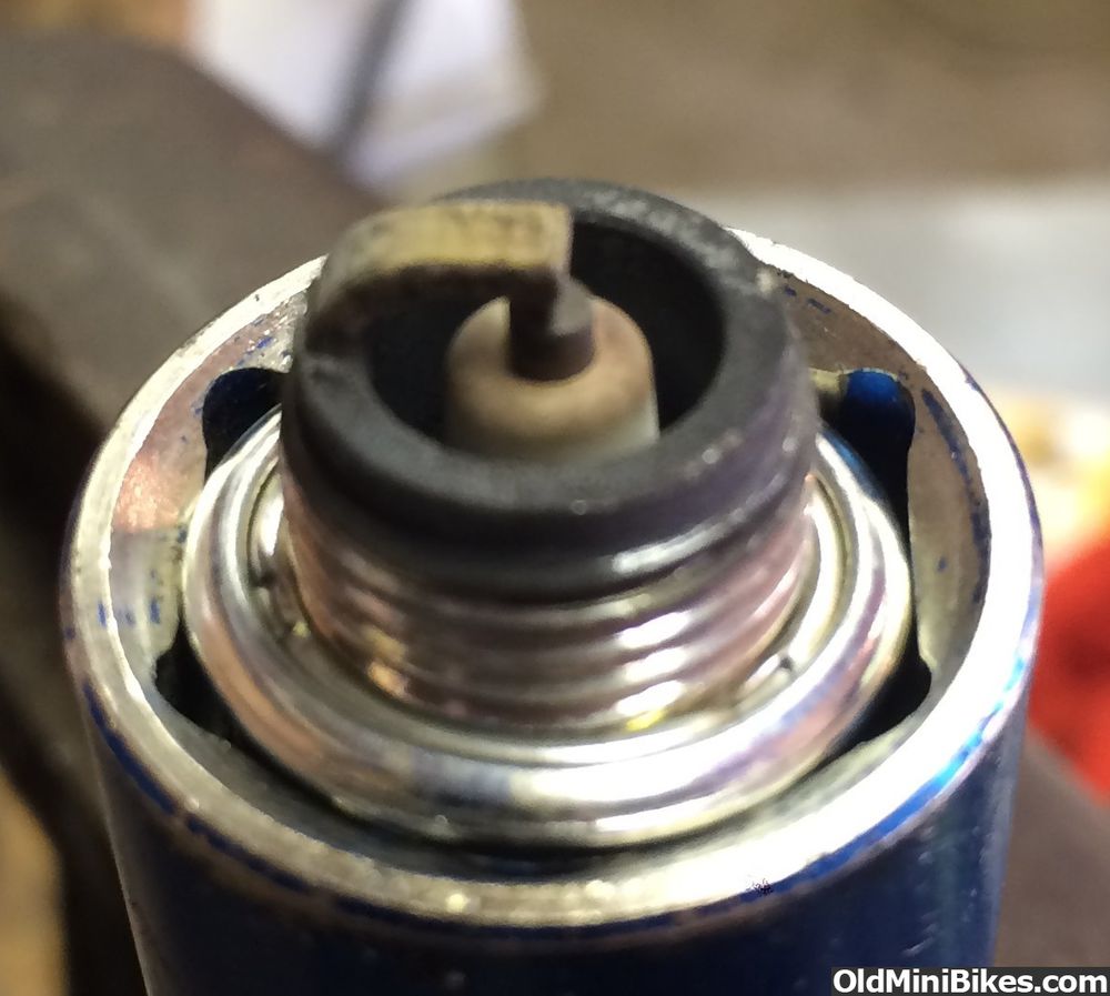

The plug was pulled and looks like this ...
That looks damn near perfect to me!!
ole4, you nailed it again!!
Thanks amigo!

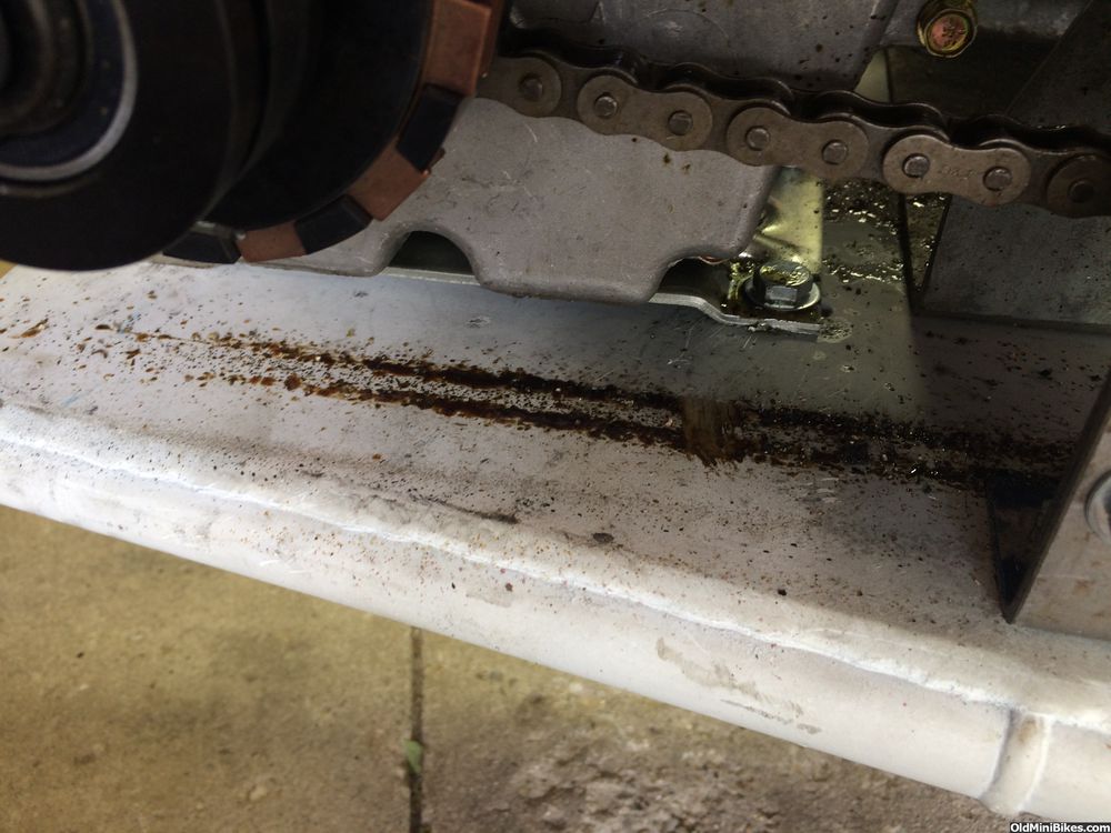

I put a #40 sprocket on the 3D clutch ... after the 25 min break in I found this ...
Its metal shavings from the New chain hitting the New #40 sprocket ...
As mentioned earlier the gearing is way to tall with the #40 set up ...
I had the original #35 sprocket, an 18t #35 jack shaft sprocket and some new #35 Extreme chain so I put those on, gearing is not as tall but still way too tall ...
However I see the same metal shaving trail on my mounting plate that I had with the #40 set up ... I didn't take it apart but for all the world it looks like the chain is hitting the 3D sprocket.
Yes the alignment is correct ... I am that anal.

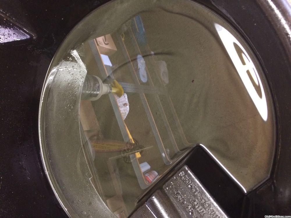

Here is a pic of the oil after the first 25 min break in ....
#47

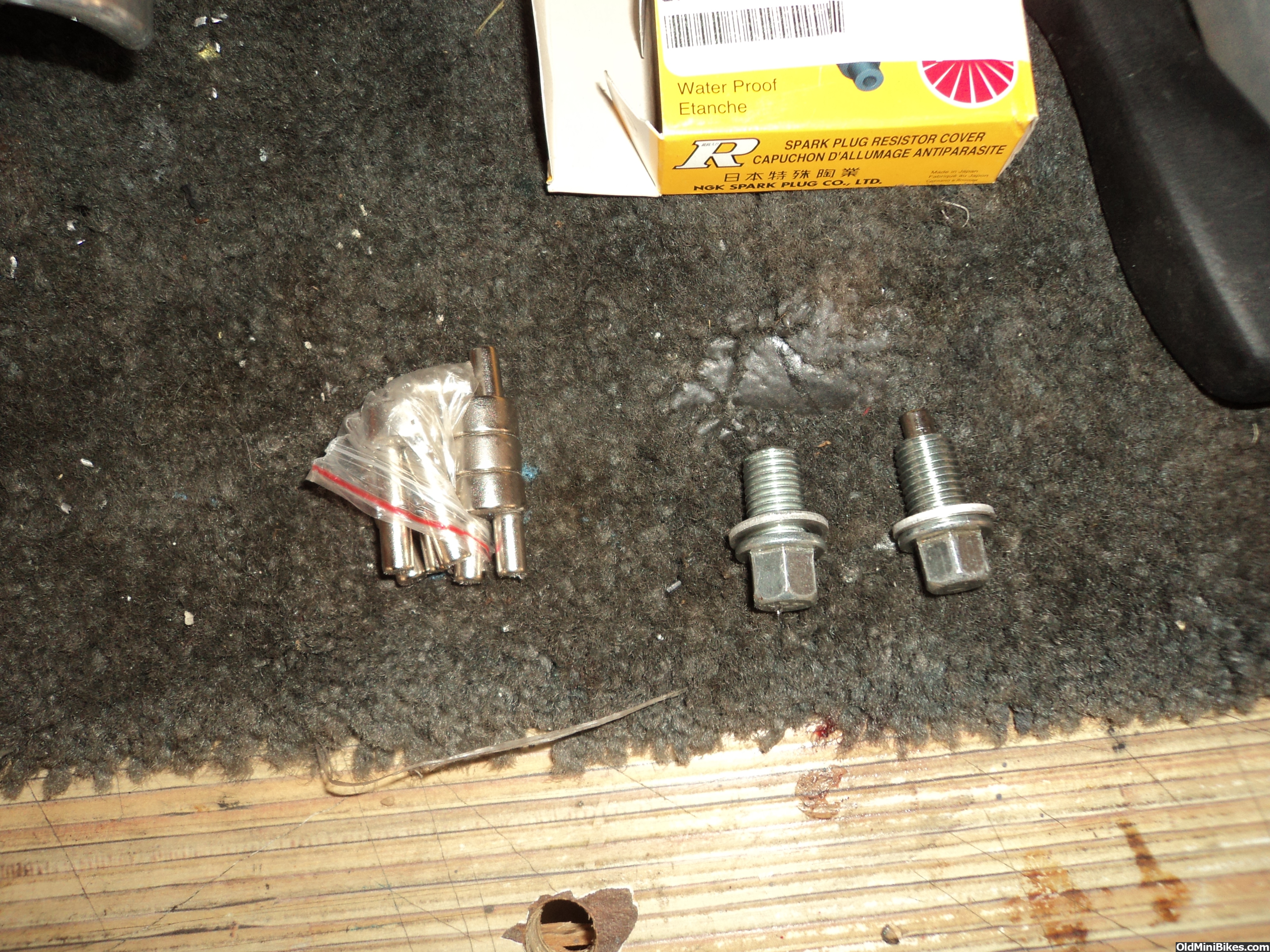

Kinda hard to see the oil picture but on my rebuilds I usually see a fine metallic sheen on the first and sometimes second oil change. I also put a magnet in the drain plug.

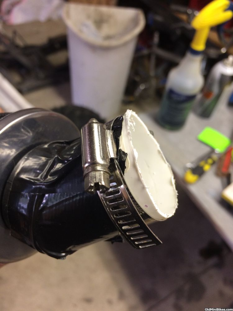

Well the air filter has proven to be a problem ... I thought it might be a ledge molded into the rubber covering the holes in the back of the carb so I jury rigged an aspirin bottle to act as an smooth intake that covers only the outside of the carb ....
That didn't work either ... without question the air demands of this motor are more that this air filter can deliver.
What air filter do I need?
