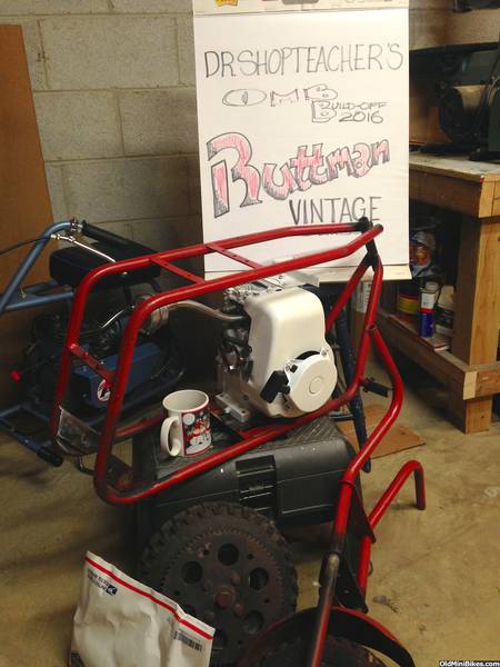

A late entry I know, but I kept tripping over this pile of parts so I figured I had better do something with it. Stock HS40 with custom Wulf exhaust. Shooting for Mopar Plum Crazy but may go back to original orange.

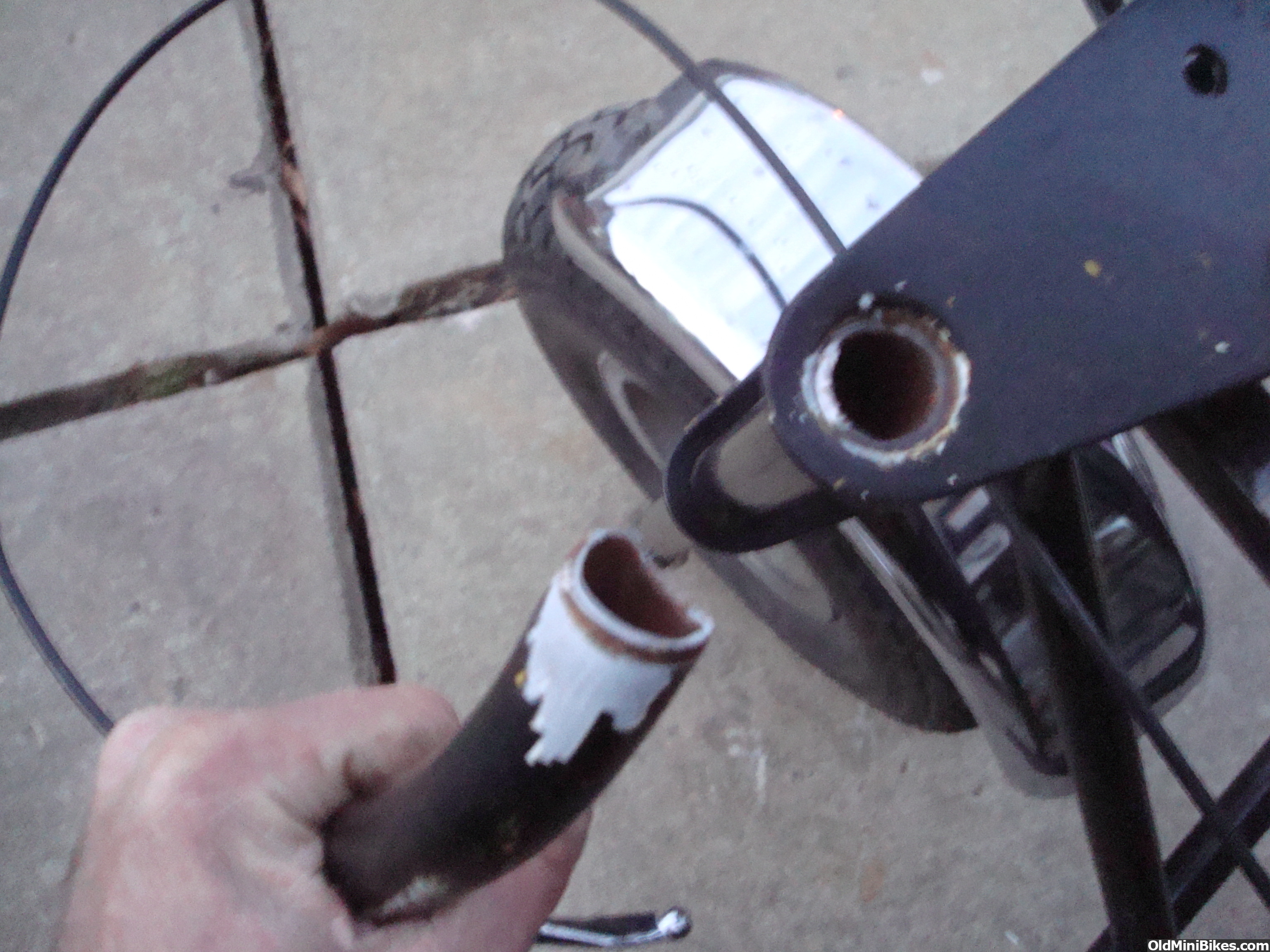

Note...Please use caution when heating a Ruttman fork to straighten them....they do not like any. Pic attached for reference.
I love those minis. Thanks for signing up and good luck with the build. I know your not taking a vote but plum crazy looks great on those bikes.
Thanks for the heads up. Got the bike from another member and he had already done some welding to fix the high speed front end. They are pretty straight now!
Thanks...I really want to do the plum crazy....the more I looked at the orange, the more yeech I felt!
