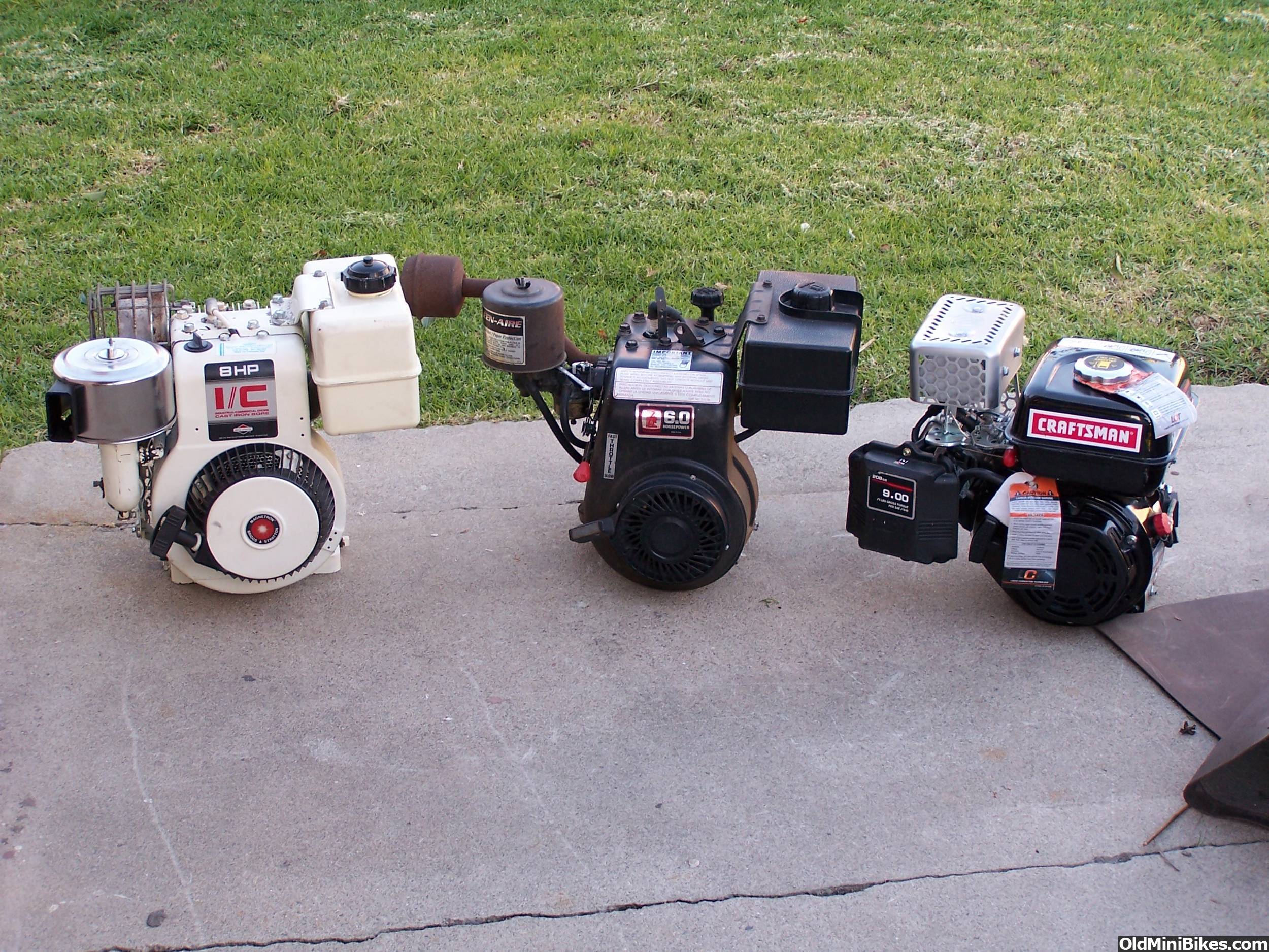

I have a clean briggs, and a clean tecumseh 10HP with lighting coil. Tec. not in pic.
Thank you George for the display of your engines... if you would like to IM me with more details and costs of your engines..or post them here..please do. I do think, honestly, if Im going to convert it will be with a brand new engine.. if its worth the effort to convert the cost of the engine is really... minimal... but I do like the more retro style of some of your engines (70-80s vintage are they?)
