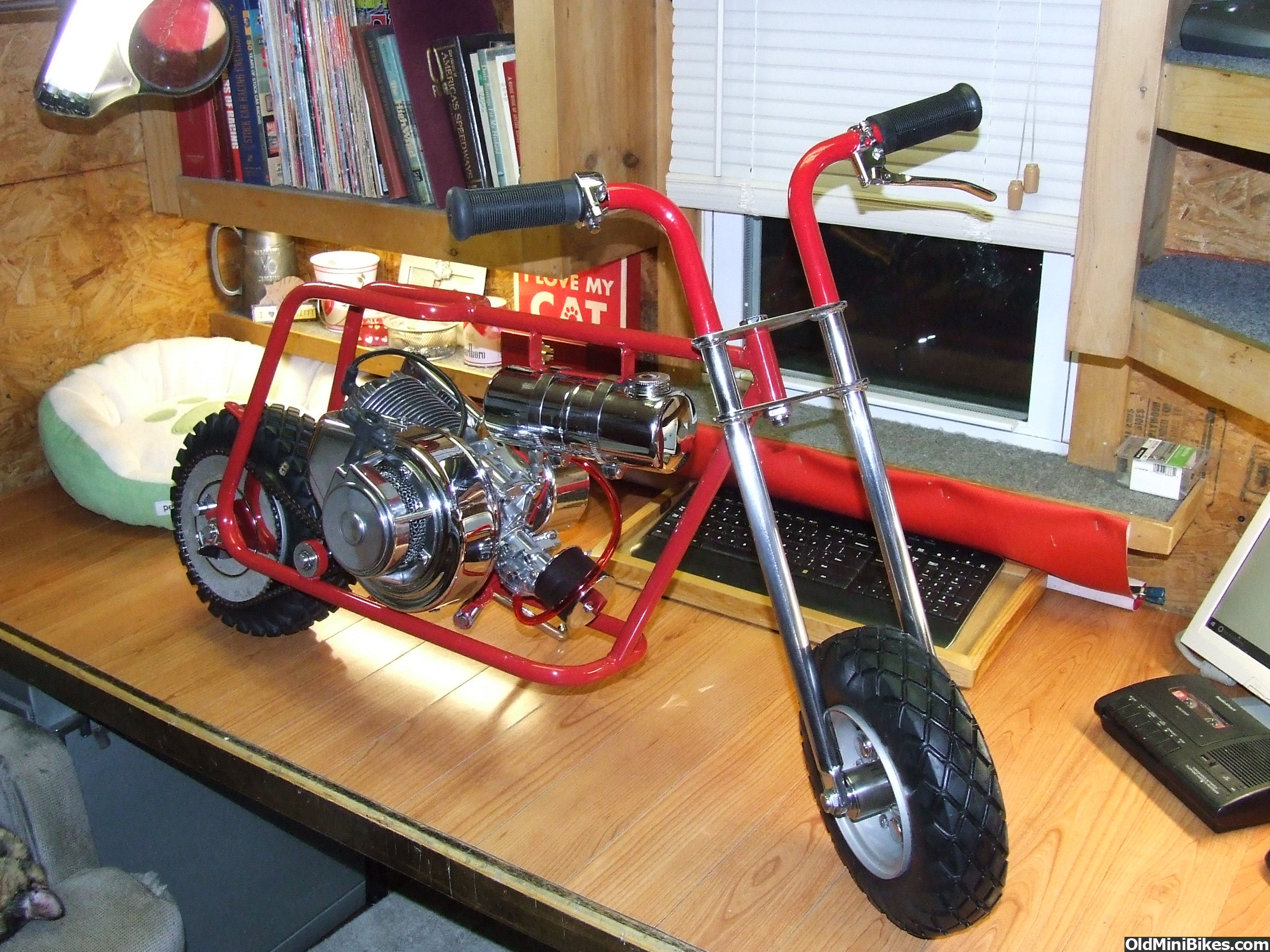

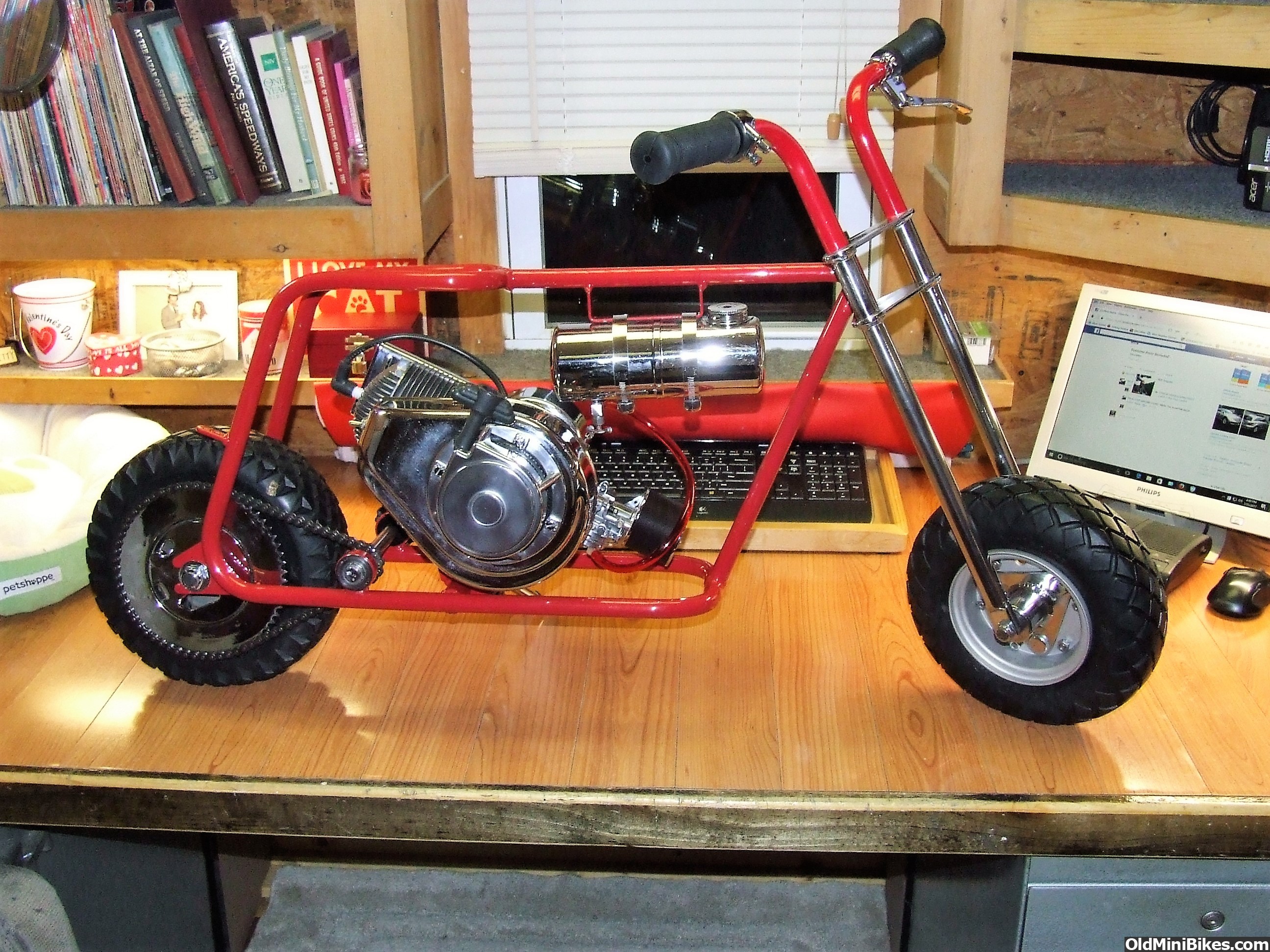

i taped the inside of the fork screwed a of thread rod inside it. then drilled holes in the Handel bars and plug weld them to the rod then finished off the weld
