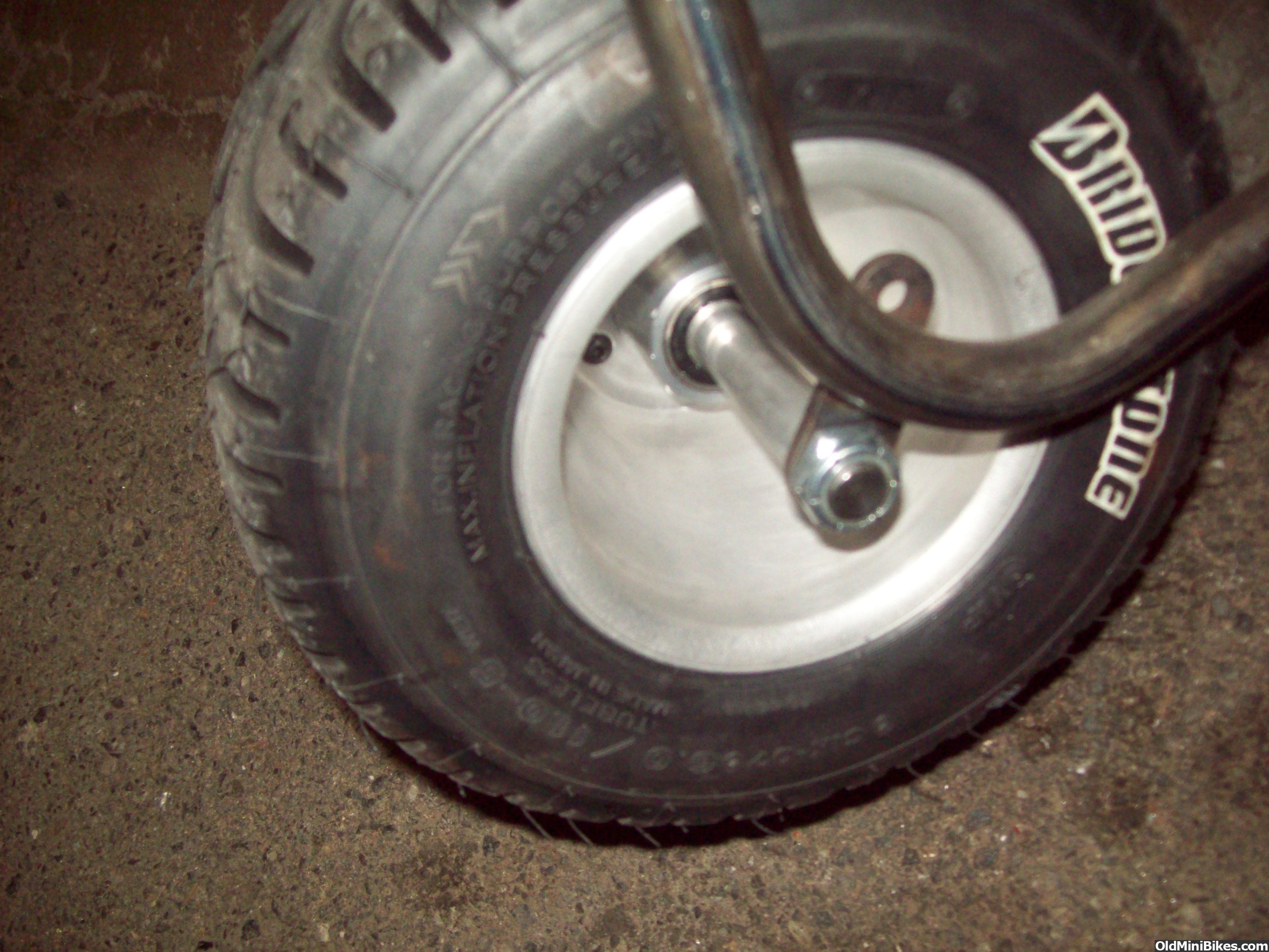

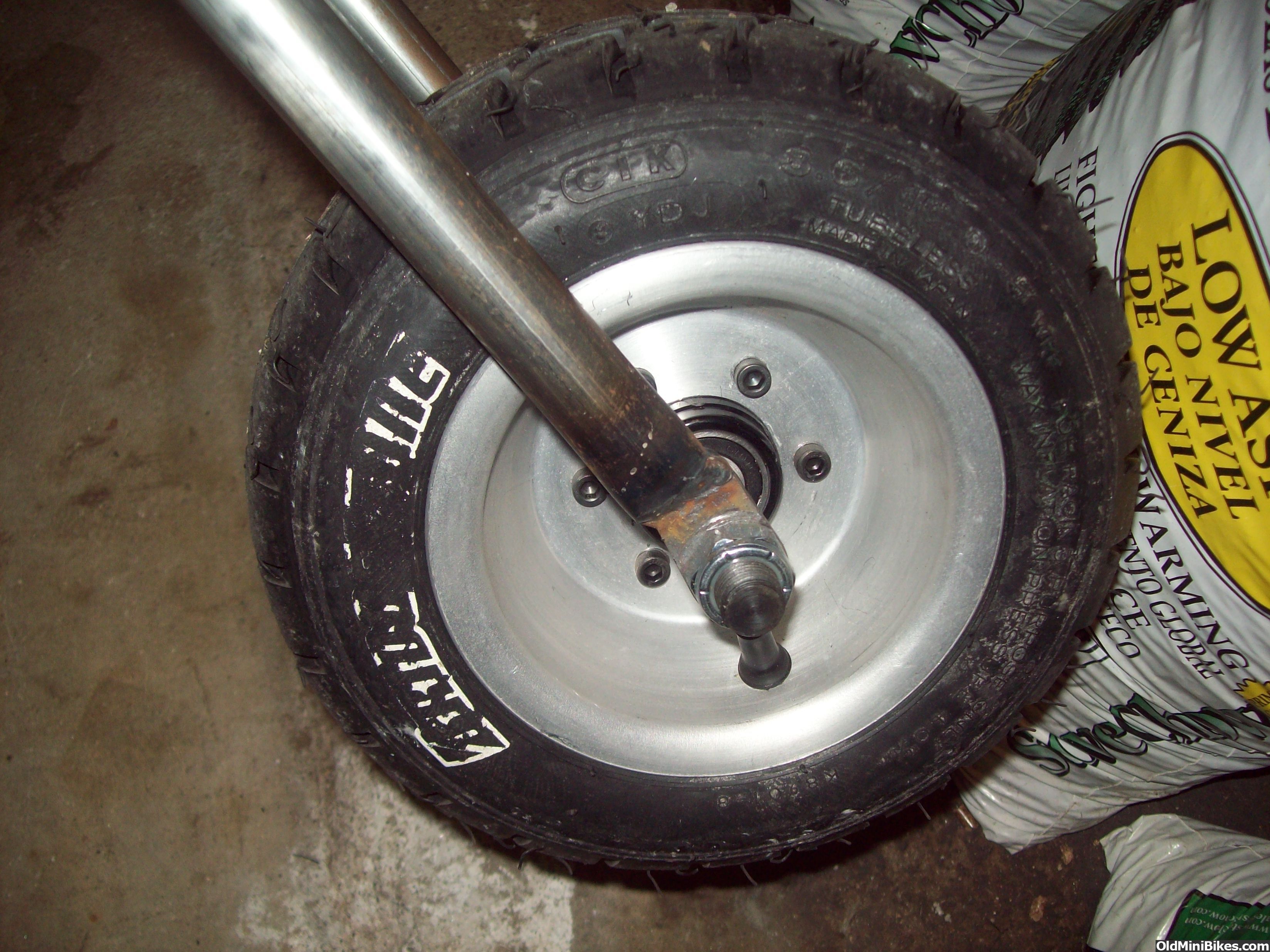

Got a question from a member on the tire and rim sizes. Start off by saying that the white lettering is not raised. It is painted on and is already starting to wear off. The sizes are Rear Rim 5" tall 5.5" wide. Rear tire is 11" tall and 6" wide. Ft rim is 5" tall 3.25 wide. tire is 10" tall and 3.5 wide.

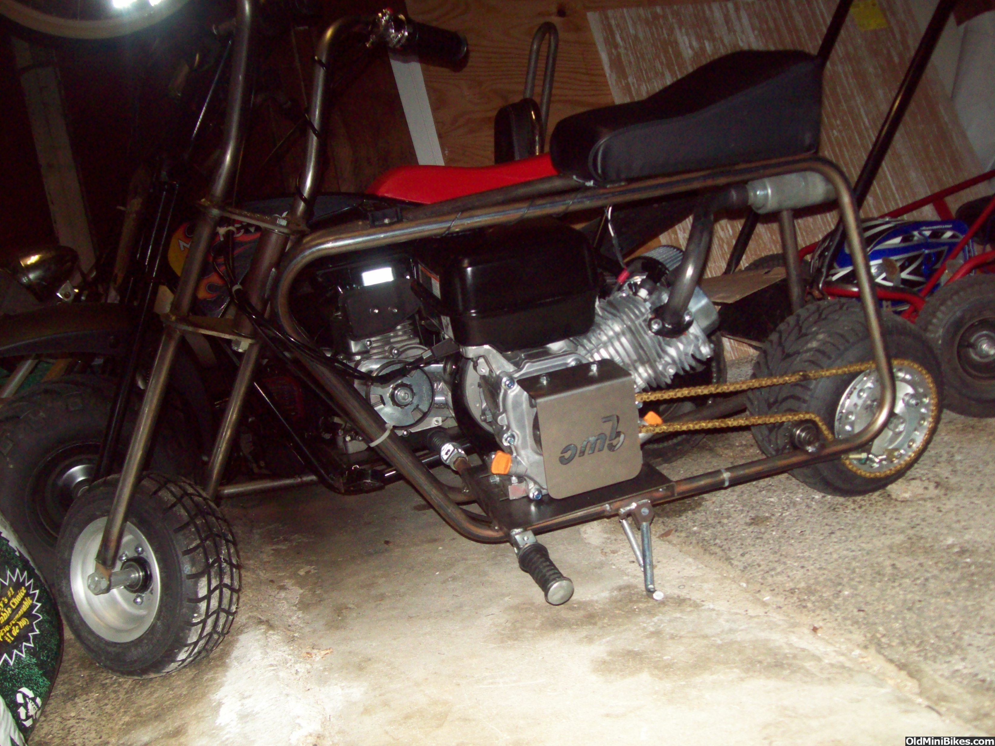

It's a Bad Dog Drag, Go to the website and save some money over Ebay. Wheel size is 5". I think the Predator turned out great. I got the Honda GVX Fly wheel , it has 5degree advance built in. I'm looking at the Raceseng billet flywheel with 8 degree advance. The timing advance really wakes the motor up.

Is there no way to adjust the stock timing by moving the mag or a offset key?

Yes, but I'm new at this and right now I don't trust offset keys. I think a adjustable coil mount can get pricey so why not go alittle more and get the flywheel. hit the search and you will find some on here that use no key at all with a billet flywheel. Doing it that way they can advance as much as they want. Peace!

Predator 212, Honda Aluminum Flywheel, 1.3 ratio rockers, 18 lbs valve springs, Max-Torque with Black Garter Spring, X-Treme Gold Chain, 54tooth ring gear, Mobil-1, Stage 1 re-jet, OldMiniBikes Tall and Narrow Header, Tiny-Tach, Bosch 4 Prong and OldMiniBikes clutch guard.
