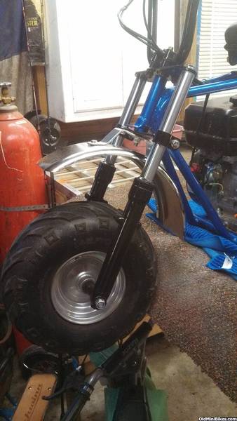

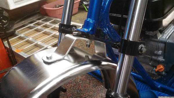

Does anyone have any photos of the steering stem and bearings for the MBX11? I am thinking about purchasing it to use on another project of mines.
Bearings? No bearings on the front fork assembly. Neck/stem bearings are on the frame, not the forks. The fork assembly lower mounting plate is adjustable so the front fork assembly will fit a wide range of neck lengths.
This thread has photos. I posted a few in post 63. There are other pictures around 4 or 5 pages in if I remember. Motovox posted a pic of the front end by itself.
