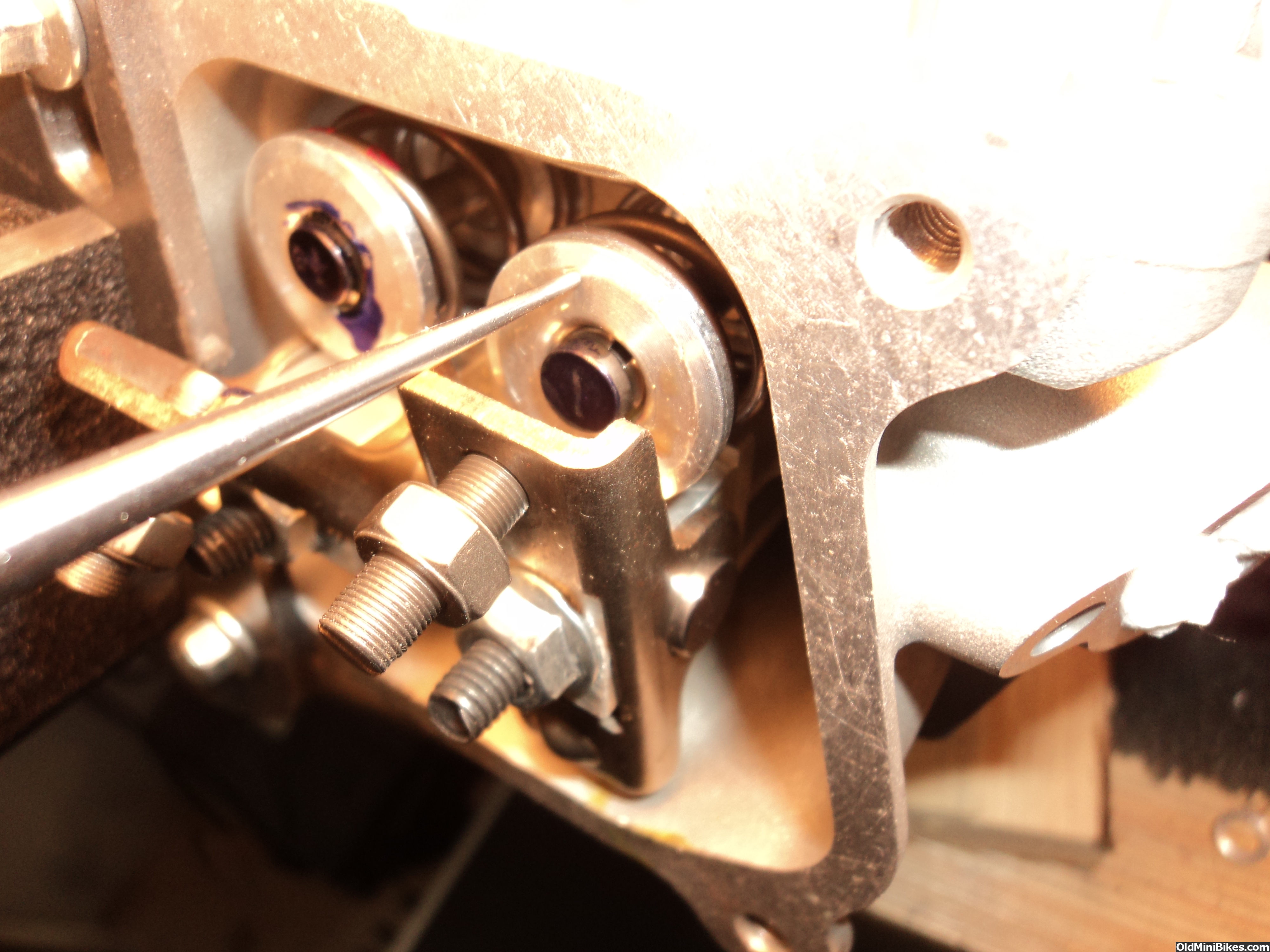

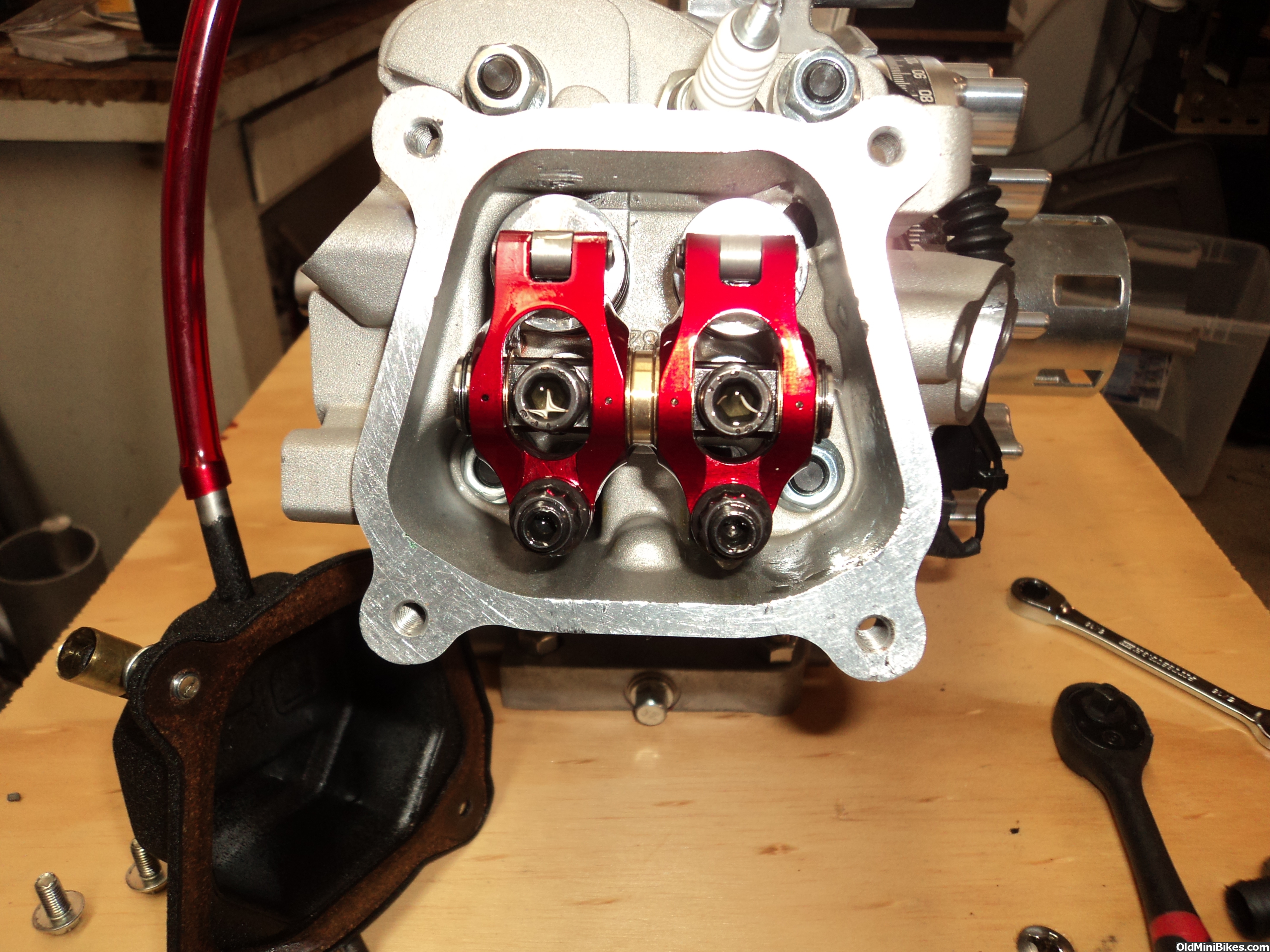

They did not measure out at 1:3 were closer to 1.1 to1. I went with the roller rockers from ec carbs. They were closer to 1.3.
Stout modified champions
Ec rollers
#83
Ec rollers
Oooohhh...:doah:. I saw a picture of the shaft mounted champions for GX200s and clones and thought those were the ones. Didn't realize these were the champions.
