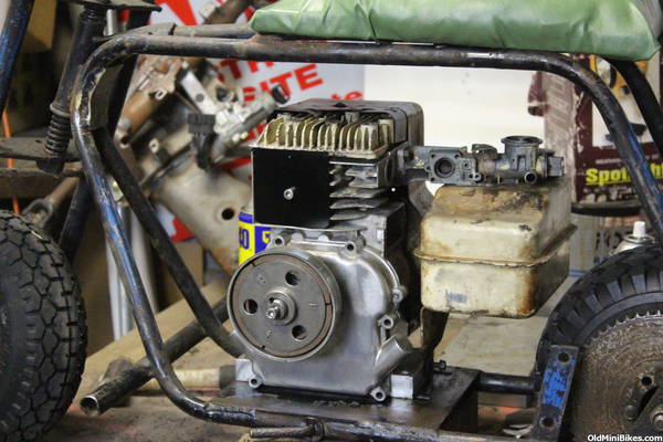

I have this 73 3HP to use. All clean on the inside but will still receive a light hone/rings/valves/piston. Gonna be done in black, so i'm gonna need to think of a bike colour to go with it.

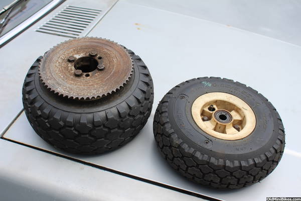

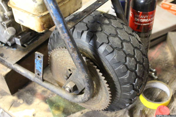

I want to keep this neat little Carlisle tyre on the rear. Barely clears the frame on one side! believe it is a 10.5-4.50-4. Never seen one like it! The front will be getting a typical 4.50-4 minibike tyre. Going to look interesting...:laugh:
The bike has a 60t rear and 11t Comet 400 Clutch. Anybody got an estimate value for top speed?

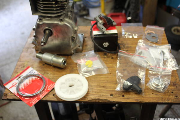

I have just done an OldMiniBikes order for 2 chrome fenders/7/8 throttle and a Piston+Rings. Can't wait!

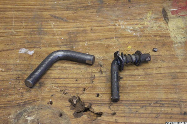

I stripped down the frame in 10 minutes flat and started to make a new kickstand. I got some slightly larger steel rod than the original stand was made from, and heated it up, then hit it into shape with a hammer. After chopping it to length I drilled the frame hole larger (for the k-stand) to accommodate the new stand, almost ripping my arm off (drill bit kept grabbing) in the process :thumbsup: I got it done though! Next is to weld some washers to it and find a new spring and I should have a fully functioning kickstand for once.

I did an OldMiniBikes order for a $23 7/8's throttle kit (I like how well they work), 2 chrome fenders and a piston and rings for the 3HP. Shipping was something like $60-70 :no:
